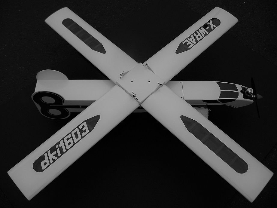

#53
Ref: Fiberglass bearing tube length in each panel is ~ 4.015"; carbon tubes trimmed w/ repetitive fit chks to eliminate end play.
Using term spar tube interchangeably with pivot tube to denote carbon tubes for wing panels in previous post.
Little bit concerned over selection of 1/16" vs 1/32"...
Since the major areas to get sheeting are right at 1" width (LE & TE), selected 4 sheets of 3" W 1/16" T sheeting to get enough material w/ excess to place 4 pcs on each panel - cutting right to size is risky. Cut 36" sht down to 30.5" L and cut width to 1.25" - cut in half for 15.25" lengths for some overhang on each panel (yielded 16 pcs). Placed sheet between T-pins to anchor on work surface and starting at the spar, applied white glue to this area only, placed panel against sheet using pins as guide to ensure alignment with spar - shimmed trailing side for first piece on each panel - started with bottoms. When dry, lifted sheeted wing assy from work surface, wet exposed surface with Windex, and even though considered against the law to use CA on balsa in certain parts of the Country, used thin variety to bond the remaining part of the sheeting to the ribs and sub LE/TE w/ capillary action. With all the bottom sheets attached, did same to top pcs - used more illegal, mid-grade CA w/ tip extension to apply glue to top of ribs - now I know why it would have been better to install the sheer webbing from the "backside" of the spars AFTER sheeting as would allow inspection and access to rib contact point w/ sheeting during closeout.
Last pic shows planing off excess sheeting; panels stiff in twisting now.

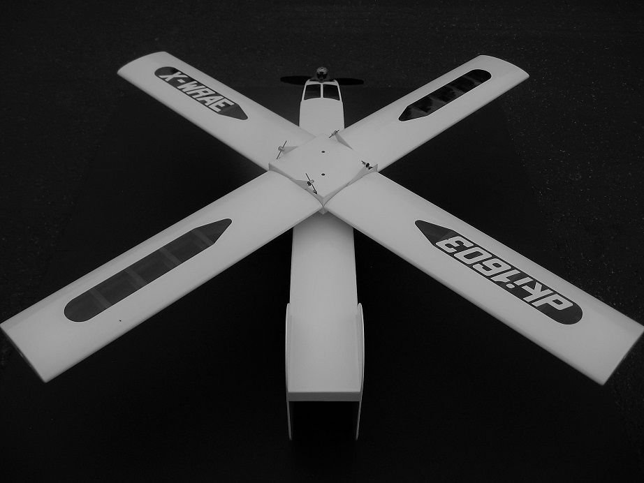

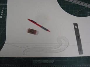

#54
Traced center root and tip wing sheeting off drawing, cut templates from cardstock, and cut blanks to fit and glue between LE/TE sheeting. Used double-face tape to stack all blanks together and cut at same time creating identical copies (8 roots & 8 tips) Fit and glued first inboard 1/4" W cap strips to index location of root sheet pieces.

#55
Leading edges comprised of 1/2" x 1/4" sticks from a Tower "Box-A-Sticks" that were super hard, dense balsa B-C grain. Cut long, glued on with white glue and taped to dry.
Marked the high point of the radius for LE and TE of each wing panel - justified slightly to the bottom of the airfoil. Shaped the leading/trailing edges with a sanding block by hand and was concerned with uniformity between surfaces -
I possess a tool that is designed to shape LE's - but only on constant chord style wings as it wouldn't work on a tapered wing panel; it works like a contour gauge with a series of cards all sandwiched together with slotted holes to allow positioning for different radii. I tried it here but didn't like the results from lack of patience/experience using this tool and ended up fabricating a dedicated tool for the task.
Also added the rest of the 1/16" x 1/4" cap strips and the tip closeouts (1/8" balsa).

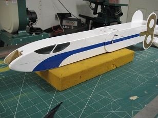

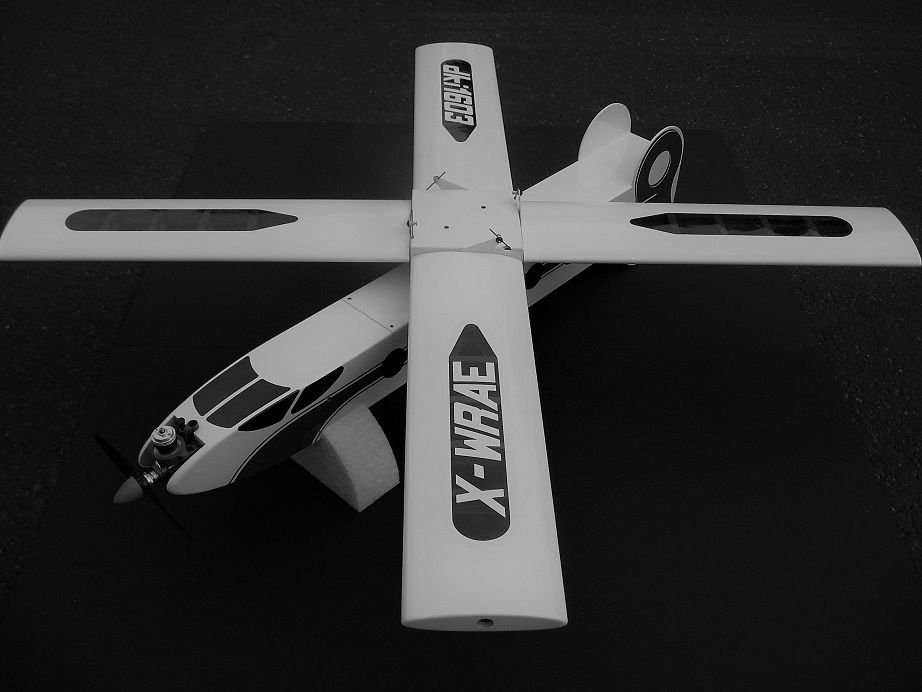

#56
A 1/32" ply side mount for the throttle servo was abandoned in favor of a tray as the front fuse side separation points don't allow flat areas for bonding - fabricated from 1/16th ply with 1/8" lite-ply doublers for more screw bite - predicted nose-heaviness allows aft-most positioning of throttle servo -
Located tank feed line hole in fuse bottom sheeting and vent hole in firewall; fabricated a custom foam cradle to position and immobilize tank; added a tape pull tab to facilitate tank removal - clearance for tank vent blister was added to top of hole on former, F-2 -
I've never used exhaust throttle on Cox engines before - installation presented numerous challenges to get it working satisfactorily - ended up using a braided cable (not pictured) with .047" Z-bent wire soldered to end attaching to throttle snap-ring.
Final coat of epoxy resin to tank compartment and sealed up fwd fuse with top sheeting, opened up hole for choke tube, and sanded excess sheeting flush -
Unused servo mount -
Substitute servo tray -
Throttle servo in mount with tri-stock gussets -
Intended throttle servo location at aft end of fwd fuse -

#57
I wanted to mount the switch harness and charge port in the airplane. Fabrication of a hatch cover for the hinge knuckle interface would accommodate these two items - a simple lite-ply hatch was weighed against component parts (except glue) to make up an identical-sized hatch using balsa for a majority of it and I was happy to see that it could make a significant difference.
After installing hardpoints and drilling to accept sheet-metal fastening screws in the four corners of the hinge knuckle interface, the mostly balsa exterior for the hatch was dealt with - cut oversize, it fits up against the top lip of the wing pylon mounting plate. By installing the four screws, locating just one of the holes allows the part to be placed on the one screw and simply pressing the balsa hatch against the other three corner screws leaves an impression to locate the other holes exactly where they need to be. The holes are opened up with a Permagrit tool that is the same diameter as the hex head of the screw. The hatch is perimeter oversize at this point and will be sanded to size at completion.
Localized hard-points for the switch mount and charge port mount were cut and shaped into two 1/8" lite-ply oval shape pieces. 3/32" balsa made up the majority with a 1/64" ply back/stiffener; the balsa cover was opened up to accept the two hardpoints as an inlay and the 1/64" ply back (also perimeter oversize) was bonded to the balsa facing with 30 minute epoxy applied to both mating surfaces and scraped off leaving minimal amount and weighted/clamped to set. The face of the hatch was sanded to get the ply inlays flush with the balsa exterior. After opening up the holes - now only large enough for the threaded body of the screw - and screwing the hatch cover to the knuckle interface, it is sanded to perimeter size to complete the part. My low budget scale only has resolution to 2 gram increments but the all-ply hatch shows approx 6 grams heavier than the built-up, "composite" hatch cover -

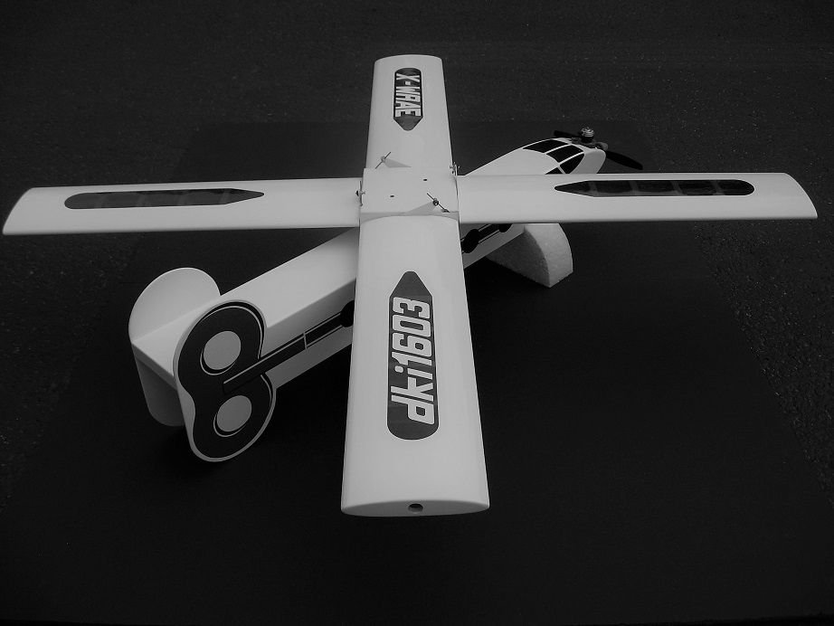

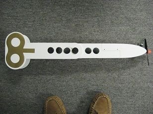

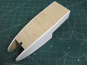

#58
Haste makes waste - rushing the project resulted in overlooking an essential requirement and that is to get wiring from the flying/control surfaces in the control distribution center section to the receiver located in the fwd fuse section. Ended up locating holes in the floor of the center section and adding a subfloor as a pass through for wiring into the pylon and down into the hinge knuckle -
Locating the four pass-through holes in the floor of cntr section -
Four holes marked -
Holes tangent to walls of cntr section -
Adding 1/16" T subfloor walls -
Last piece -
Addition of subfloor support spacers -
Fitting pylon -
Pass-through for servo connectors and wiring in pylon -
Top holes allow for connector clearance on sides from subfloor -
Blank sheeting to fit hole for pylon on subfloor -
Lay out for hole -
Subfloor hole fit of pylon -
Slight oversize perimeter layout of subfloor from holed blank -
Revised holes for connector clearance -
Sub-floor installation on control distribution center section -

#59
A .155" hole was drilled in drill block to hold release pins for master hinge knuckle while drilling. Pins were drilled out for .047" wire and checked for trueness then roughed-up wires bonded in with Hysol. Because the output wheel holes aligned with holes in the sides of the master hinge knuckle only in neutral position on servo, alignment at servo endpoints caused quite a bit of flexing and binding issues so another arm was substituted to split the difference between servo center and end points to "balance" linear action from the rotary output -

Calling the airframe complete sans covering -
The center section cover/hatch was not remaining flat with the original, ply/balsa sandwich, so another 1/64" skin was added above the balsa with major grain now running chordwise to stiffen the whole thing up.
The small box closeout or ramp mentioned back in post #47 was added to the ascend of the tail section and hole added to accommodate the fuel line with fuse in folded position. Triangle stock in the corners could have done the same job here...
All airframe components were sanded with edges and corners rounded.
One picture shows various hardware items that go into the airframe including horns, spacers, washers, screws, a receiver, battery, switch harness, engine, fuel tank, magnets, throttle and release servos, extensions, and spar carry-through.
Weight of the airplane at 21.5 ounces prior to covering.
Ply/balsa/ply center section hatch and notches to clear pushrods -
1/16" balsa ramp tail closeout component parts -
Installation -

#70

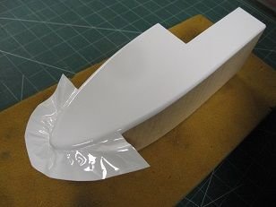

Finished base covering process with nose and looked at trim scheme -
Heat stretching covering at fwd nose section -
Fwd nose section trimmed before covering top -
Trim planning layouts -
Template pattern layout -
Basic trim applications -

#71

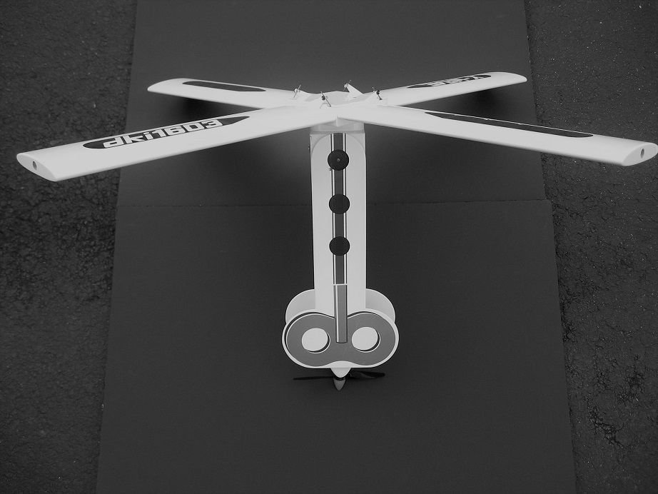

The airplane all-up weight after covering is 24.85 oz. -
Each wing panel is 15" span with a 4" chord and the center section measures 4" square, so calling wing area 250 square inches - divided by 144 to get square feet -
24.85 oz. divided by 1.7361 square ft. = calculated wing loading of 14.31 oz. per sq. ft.
Forward flight mode -

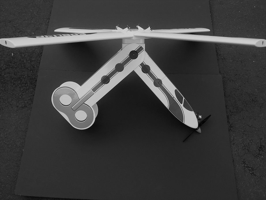

Halfway through conversion -
Failsafe descent or destruct mode -

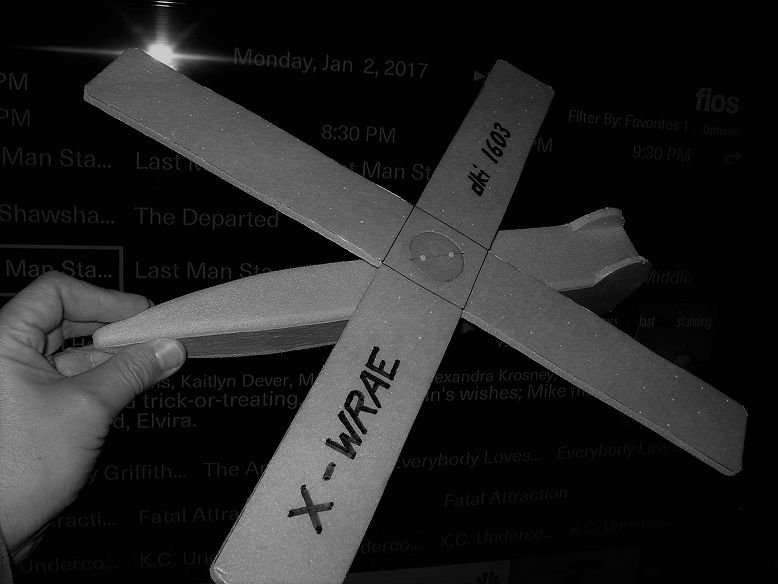

First prototype chuck glider from fan-fold-foam -
